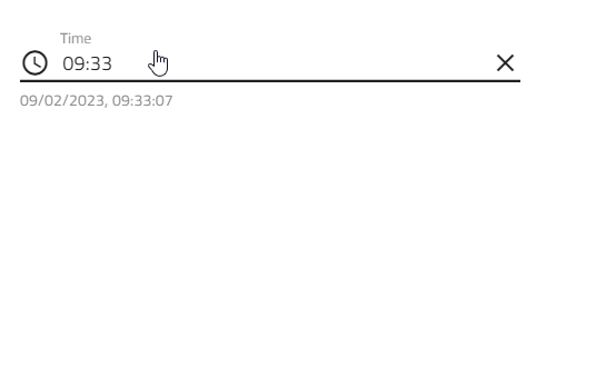

    The described scenario could be observed here:
    In addition, I have prepared small sample illustrating this behavior which could be found here. Please test it on your side and let me know how it behaves.
