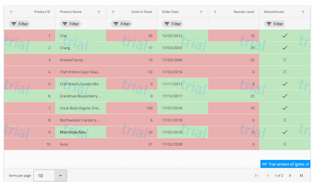

    I have been looking into your description and tried to recreate a similar setup in this sample. I think I managed to achieve something similar. An unknown piece that remains is how the columns have their editable property bound – what is the function and its parameters? This may be a crucial part of the scenario and could be related to any unexpected behaviors.
    Nevertheless, the sample suggests an approach, possibly different than yours, to achieve what I understand is your requirement – tab navigation among only the editable cells, which can also dynamically change.
    The solution involves handling the gridKeydown event for the ‘tab’ and ‘tab + shift’ combinations and essentially overriding the navigation logic in these cases by seeking for the next or previous editable cells. Please, refer to the sample .ts code for the implementation details.
    The cellEditEnter event of the grid is also handled to cancel entering edit mode for a non-editable cell (by clicking). That is, since the editable property of the column is left as 'true' and the edit mode is rather programmatically handled. The sample also leverages the cellClasses to style the cells as red/green.
    In conclusion, please, check out the sample and let me know if it helps. Please, feel free to further adjust it based on your existing logic. As an application-level solution, also make sure to fully test it against edge scenarios.
