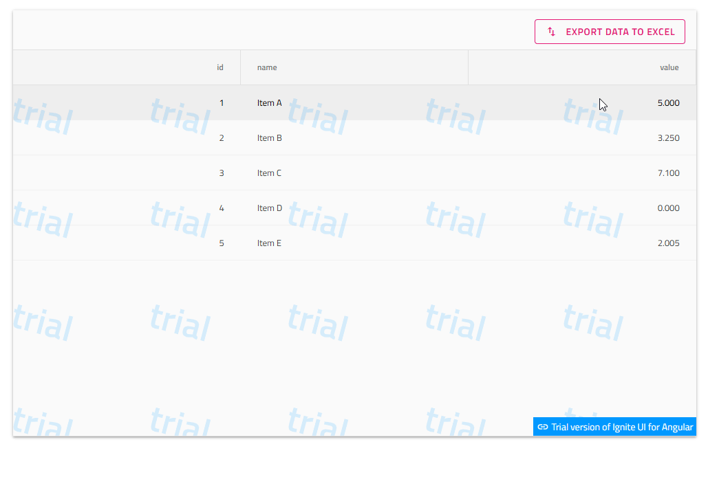

The described scenario could be observed here:
You can see a full working example in this StackBlitz sample I’ve prepared: View StackBlitz Sample
